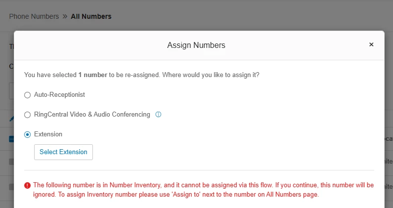

Dec 29, 2025 10:03 PM UTC
From the “all numbers” page I am attempting to assign an inventory number to a site that I have created until I get the perm number ported in. When I select any of the options I am instructed to go to the page I am already on to do what I have already done….Any thoughts?

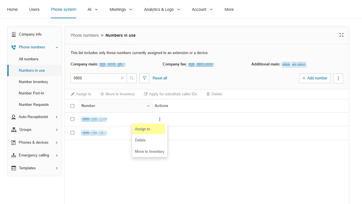

Dec 30, 2025 2:16 AM UTC
​@phil
you need to scroll to the right and click the ⋮ Actions > Assign to.
Pic below is from a test account. I have hidden all columns except for Number and Actions.On your end Actions is the rightmost column.
Dec 30, 2025 3:20 PM UTC
This was the answer I needed! They really should not have the link that I used available if it is not going to work. From my view I was not even aware the other two columns existed. Thank you for your help!
