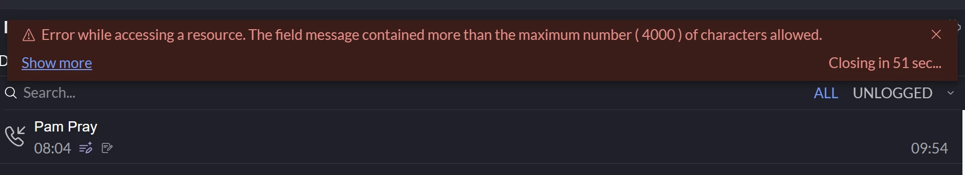

My customer service reps keep seeing an error message says there is a 4000 character limit causing the transcript and notes to fail to log. If this is actually a thing, this tool is not working. I would say a good 75% of our agent calls are longer than 5 minutes and some may last upwards of an hour. 4000 characters is easy to exceed and I watched 2 separate calls have this pop up and now no records were stored in NS. Can someone tell me if I am doing something wrong or offer some insight on this? Thanks!

@zach-3 This is a good catch, and this is something we should be able to fix. I will ask my engineers to work on this right away.
The likely solution will be something like this:
  • If the call log is > 4000 characters with the transcript, we will log the transcript in NetSuite
  • If the call log exceeds 4000 characters, we will include the call summary, but create a link to view the transcript in RingCentral
We will also research other solutions to get the transcript into NetSuite -- somehow circumventing the 4000 character limit. Perhaps we could attach the transcript as a separate file? Not sure what the solution will look like. But hopefully NetSuite will have some kind of solution we can use.
  • January 30, 2025
@zach-3 One thing you can do in the short term is turn off the logging of transcripts under “Call log details” under Settings. This will help restore the logging of calls, while we figure out how to get transcripts stored securely in NetSuite.

@zach-3 The only reasonable explanation is that the transcript is pushing it over. I don’t know of a good long term fix that is quick and easy - short of truncating the transcript all together. A slightly more complex solution would be to attach the transcript as a file. But that will take time to research.

We are looking into two solutions. In the short term we will truncate the transcript (and add a small note) just so that the call will be logged. Longer term we are looking into uploading the transcript and attaching it as a file.
