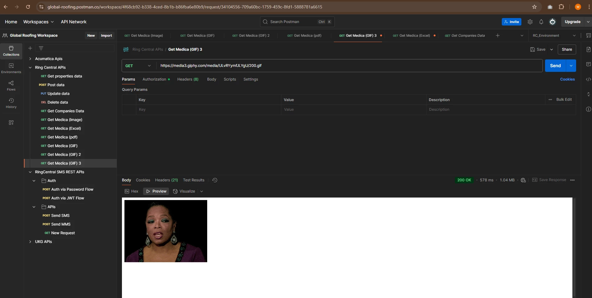

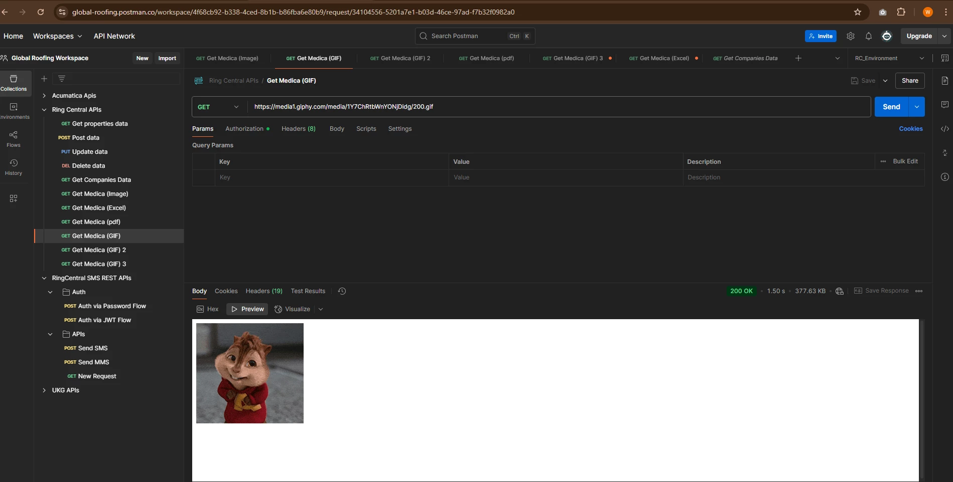

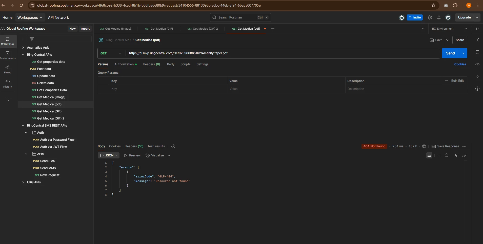

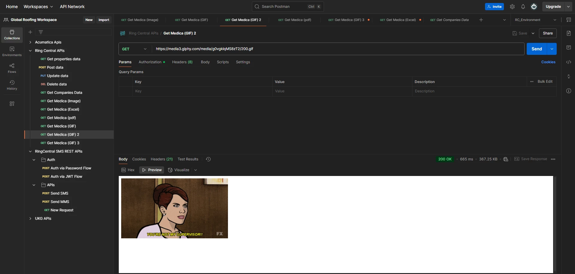

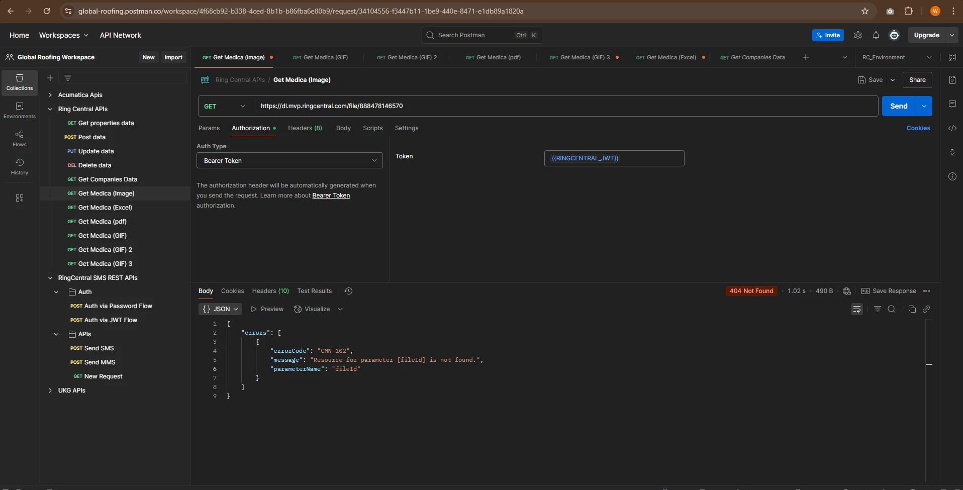

Hello,
I am trying to construct the URL to fetch media objects from the conversations through API calls. The documentation is not very clear on how to do this. I am able to only pull gif media objects through the get request but can’t be able to pull any other types of media objects  using the same method that I have been able to successfully pull media objects. Can I kindly get some assistance on how to create the proper URLs to pull pdfs, CSVs  and other type of media objects as I have not found any examples of how to create urls.
Attached are some screenshots of the responses of gifs and other media types

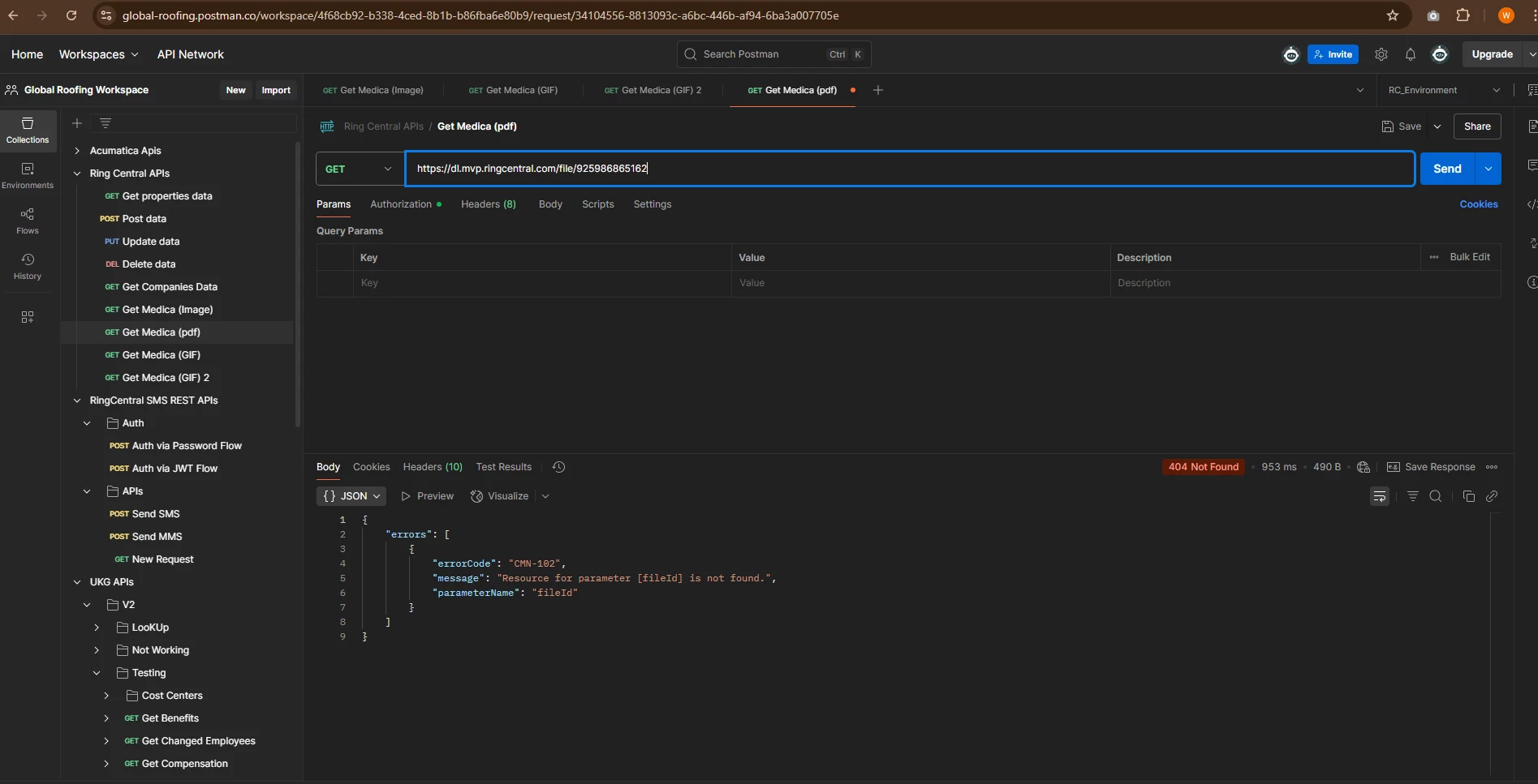

The error message clearly indicated that the fileId is not found. Where did you get the contentUri with the id? Did you read it from the a team and detect the id from the attachments object?
Hello ​@PhongVu Thanks for your response to this.

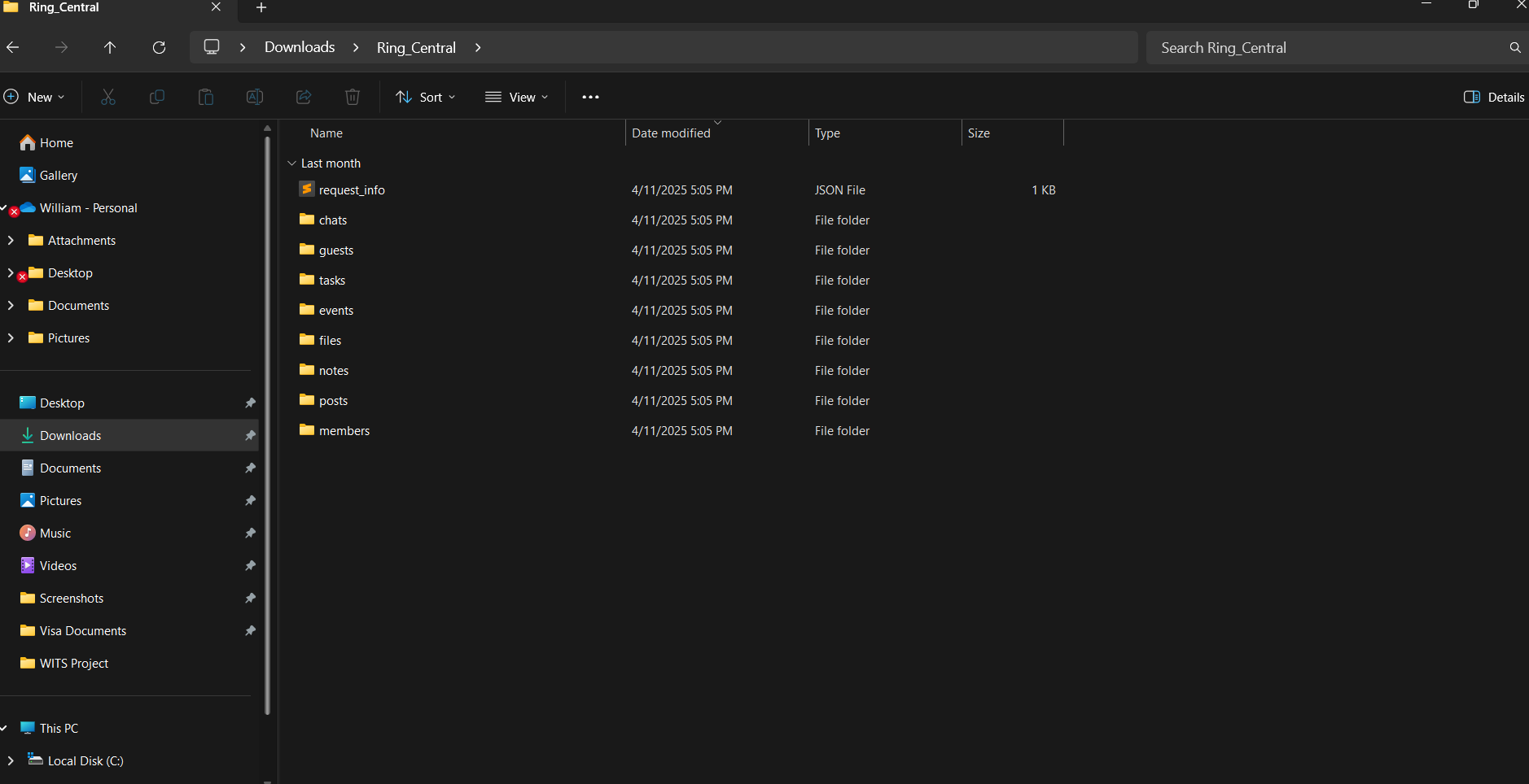

I just picked the contentURI from the export job that I created. I created an export job that gave me a file with the below content shown on the screenshot
I then used the contentURI from the export job to try and retrieve the media object. The media objects are in the folder named Files

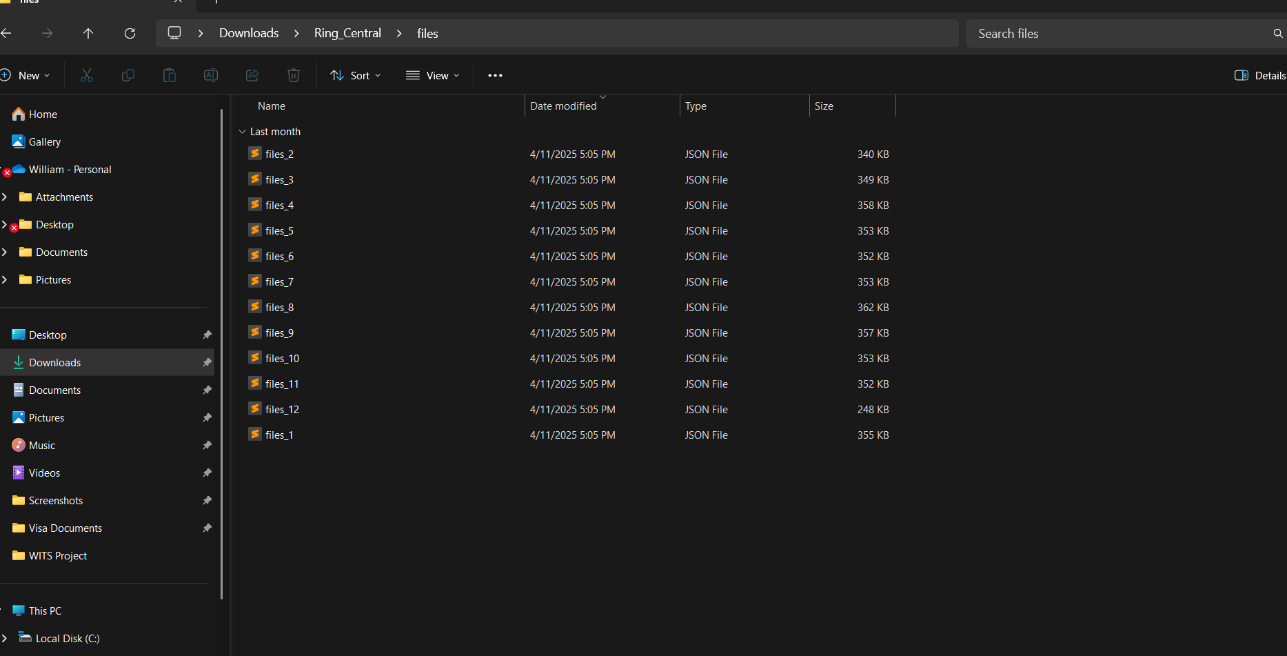

Attached is the screenshot of the exported JSON files containing media object details, contained within the files directory
In the Files Directory
This here is sample object I obtained within one of the JSON files. The JSON files contain lists of objects in the format provided below:
    "id": "846731247626",
    "creator": {
      "id": "62579284004"
    "chatIds": [
      "923061387266"
    "creationTime": "2020-03-19T21:58:40.622Z",
    "lastModifiedTime": "2020-07-09T14:51:09.192Z",
    "lastModifiedBy": {
      "id": "62579284004"
    "name": "image.png",
    "size": 78745,
    "contentUri": "https://dl.mvp.ringcentral.com/file/846731247626",
    "deleted": false,
    "type": "File"

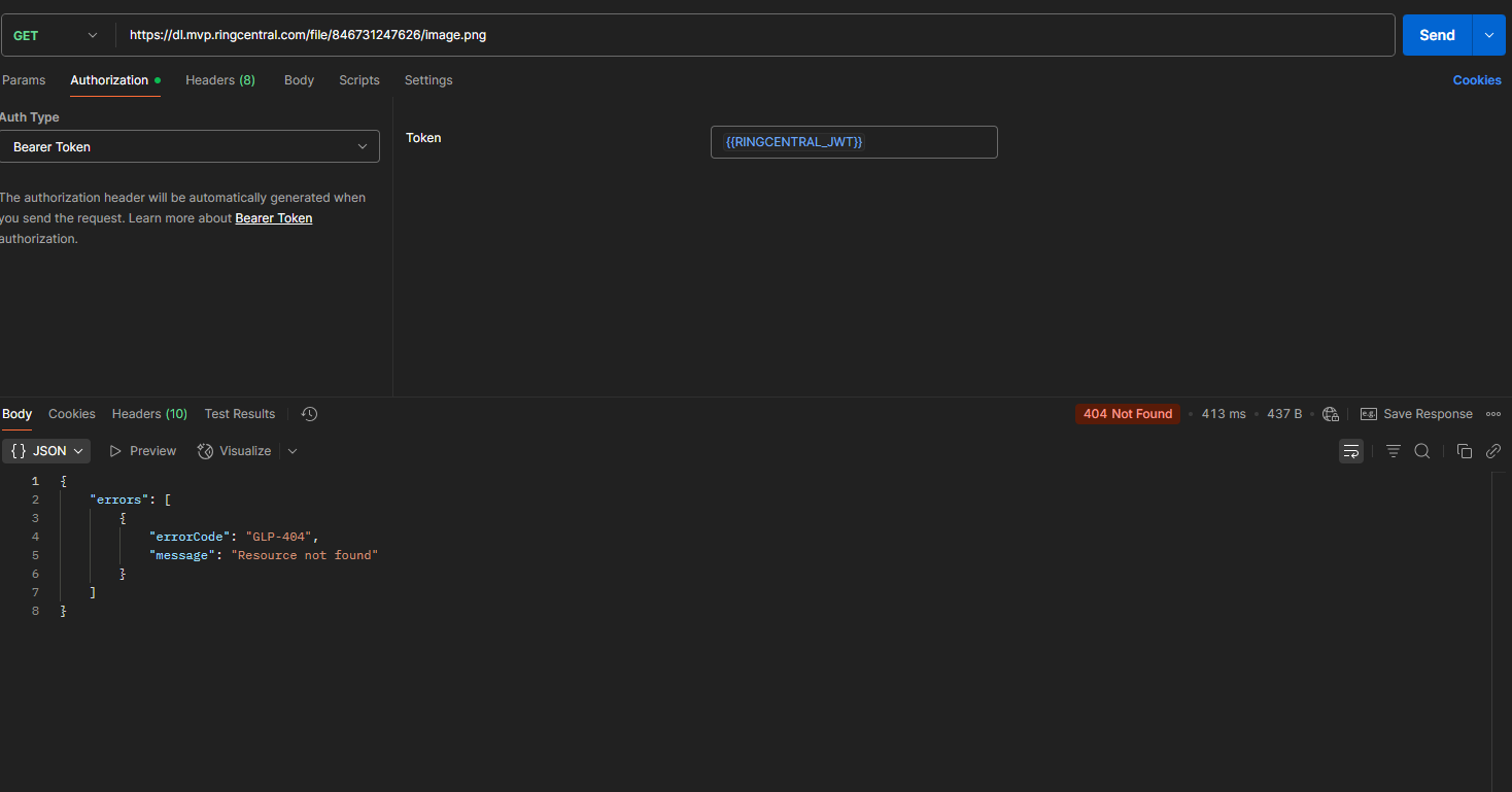

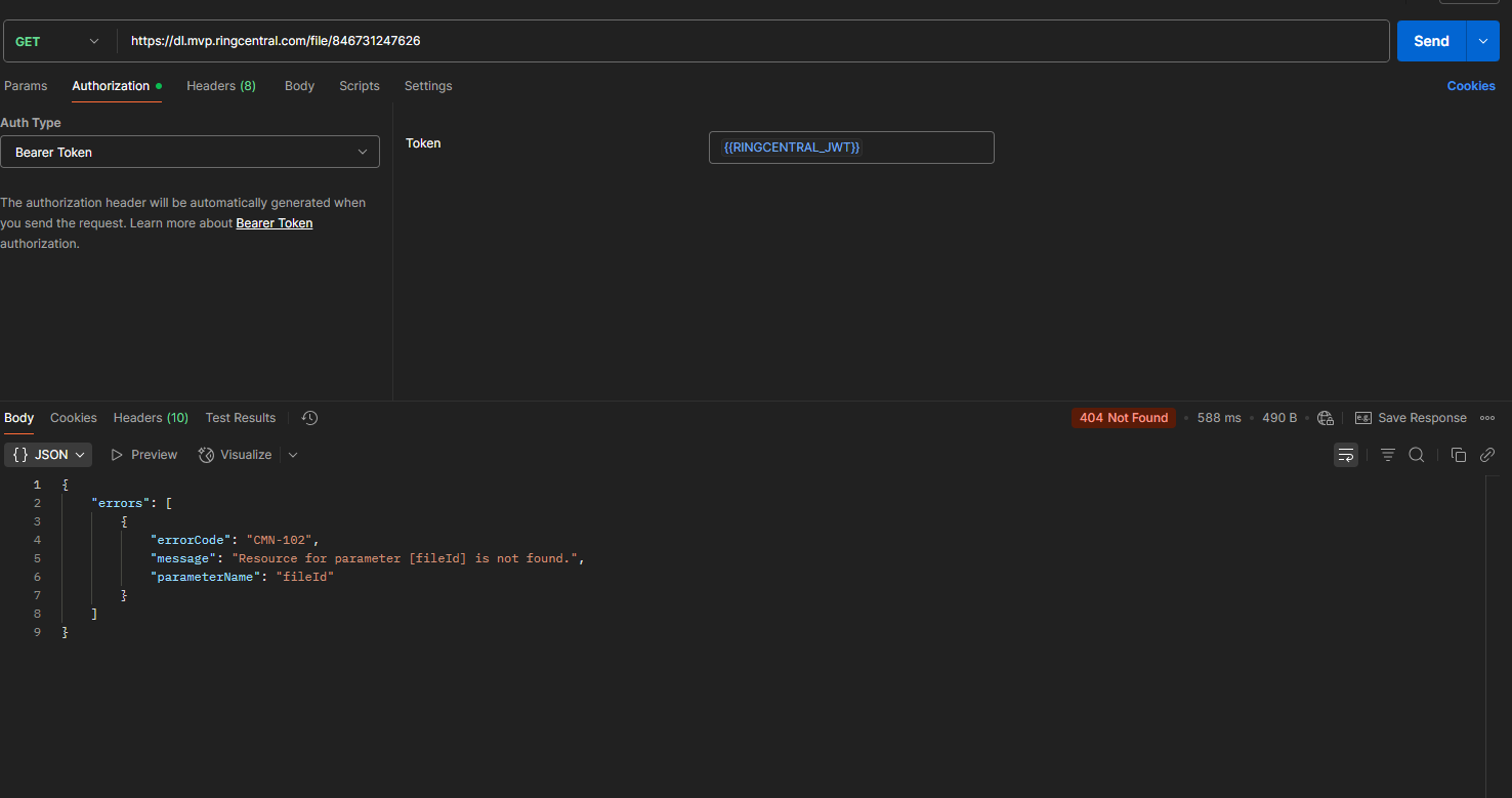

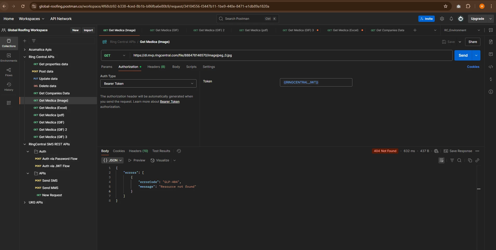

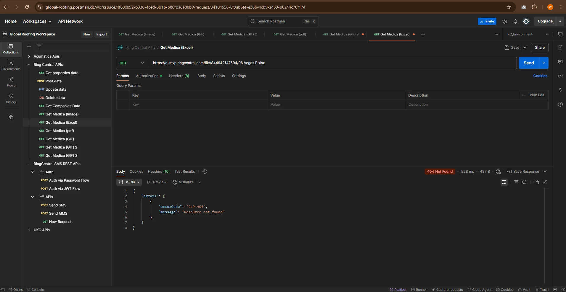

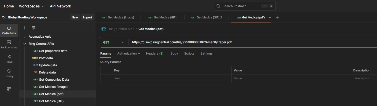

For a literal example, I am attaching screenshots of the get request I made using the above sample object:
Request 1
Get request made with contentURI + the media object name
Request 2
Get request made with contentURI only
I hope this is clearer to explain my challenge. Hoping to get a solution to this soon as I have been stuck on this for a while trying to figure out how to build a proper request.
  • May 20, 2025
In that case, the second screenshot is correct. You don’t add the file name to the end of the contentUri.
Now I am not sure about the error. Can you double check the access token you used in your postman is generated for the same user who exported the team messaging compliance and under the same account?

@PhongVu  Thanks for this. Let me try this and will let you know the progress
@PhongVu Thank you so much for the assist.
This really helped me get past the issue I had
