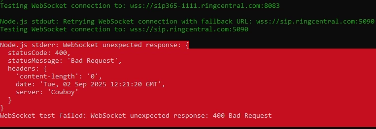

async function testWebSocket(wsUrl, sipInfo) {
    console.log('Testing WebSocket connection to:', wsUrl);
    try {
        await new Promise((resolve, reject) => {
            const ws = new WebSocket(wsUrl, ['sip'], {
                headers: {
                    'Origin': 'http://localhost',
                    'User-Agent': 'ringcentral-web-phone/2.2.7',
                    'Sec-WebSocket-Protocol': 'sip',
                    'Authorization': `Basic ${Buffer.from(`${sipInfo.username}:${sipInfo.password}`).toString('base64')}`
            ws.on('open', () => {
                console.log('WebSocket connection successful to:', wsUrl);
                ws.close();
                resolve();
            ws.on('error', (error) => {
                console.error('WebSocket connection failed:', error.message);
                reject(new Error(`WebSocket connection failed: ${error.message}`));
            ws.on('unexpected-response', (request, response) => {
                console.error('WebSocket unexpected response:', {
                    statusCode: response.statusCode,
                    statusMessage: response.statusMessage,
                    headers: response.headers
                reject(new Error(`WebSocket unexpected response: ${response.statusCode} ${response.statusMessage}`));
    } catch (error) {
        console.error('WebSocket test failed:', error.message);
        return false;
    return true;

        const sipInfo = await getSipInfo(platform);
        // Test WebSocket connection
        const wsUrl = `wss://${sipInfo.outboundProxy || 'sip.ringcentral.com:5090'}`;
        const wsUrlFallback = 'wss://sip.ringcentral.com:5090';
        let wsSuccess = await testWebSocket(wsUrl, sipInfo);
        if (!wsSuccess && wsUrl !== wsUrlFallback) {
            console.log('Retrying WebSocket connection with fallback URL:', wsUrlFallback);
            wsSuccess = await testWebSocket(wsUrlFallback, sipInfo);
        if (!wsSuccess) {
            console.warn('WebSocket test failed, proceeding with WebPhone initialization...');

Error Output:
WebRTC error: WebPhone userAgent is undefined after start Error: WebPhone userAgent is undefined after start

error is same as above
Please give me why this issue occurs here.
Thanks.
