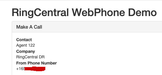

First of all, when you login your web phone, you should find the phone number of the user. Copy that phone number
Then when you have a connected call session from the soft-phone (your server phone), call the transfer function to transfer the call to that user phone number.

callSession.transfer("+1650XXXXX"); // phone number shown in the web phone!
