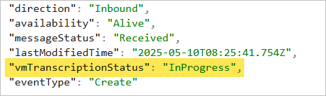

Please double check and let me know if the event is fired too soon before the transcript is available.
In my testing so far, it has always triggered immediately. I’m sharing one of the payloads with you.
As a result, I’m now reluctantly relying on calling the Message endpoint /restapi/v1.0/account/~/extension/~/message-store/{messageId}, which is unnecessary and adds an extra hit to the RingCentral API, just to retrieve the transcription after waiting for 20 seconds.
I'm confident that if you try it on your end, you'll get the same results.
If we can resolve this, we can eliminate one unnecessary hit to the RingCentral API. Alternatively, could you suggest a filter or another approach that would allow me to create a subscription with an option to receive a notification once the voicemail transcription is ready?
  • May 13, 2025
You are right about the voicemail event with the vmTranscrioptionStatus = InProgress. It depends on the length of the voicemail though. In my test, if the voicemail is short (around 1 min) then the status in the event is “Completed”, if the length of the voicemail is longer than a min, then the status in the event it “InProgress”. I think the voicemail event notification subscription has a threshold to fire the event. For now, the best solution is to check the status, if it’s completed, then proceed the normal way you need to process the voicemail, if it’s “InProgress” then set a delay then poll it using the /message-store/messageId API to read/check then proceed accordingly etc.
