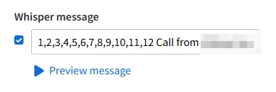

Hi ​@ipadagas, I have dealt with the same issue in the past. This occurs because the call is considered “picked up” as soon as it is received, so the whisper message plays immediately even though the call recipient may not have actually picked the call up yet. After a bunch of back and forth with CallRail and RC support, we determined the best way to account for the delay is to put in a bunch of numbers as fillers in the whisper message prior to the actual message that needs to be played, see below as an example:
I would suggest this as a workaround, we have not had an issue with this since applying this change.

The whisper message plays immediately as soon as it is received on the RC side, so if a customer is holding in a queue then the amount of numbers prefixed would probably need to be adjusted to accommodate for the additional time. Not a perfect solution, but the best workaround I was able to find for my specific issue.
