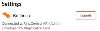

However, we have discovered that calls are now being logged, but AI transcriptions are not being added, even though server side logging is enabled and connected through the API users. I have tested the credentials, and logged into Bullhorn to establish the connection through the API user account.
AI transcription continues to work for Bullhorn admin accounts.

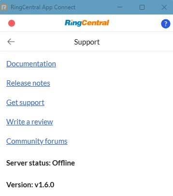

The server status shows as Offline on clients, even though the API user appears to be connected. The App Connect client is showing as connected by their Username (Admin) on the clients, so it seems that server side logging is enabled and working.
It appears to me that perhaps the API users could be establishing the connection, but still requiring user access to update the notes - though this doesn't explain Offline status on the App Connect client.
