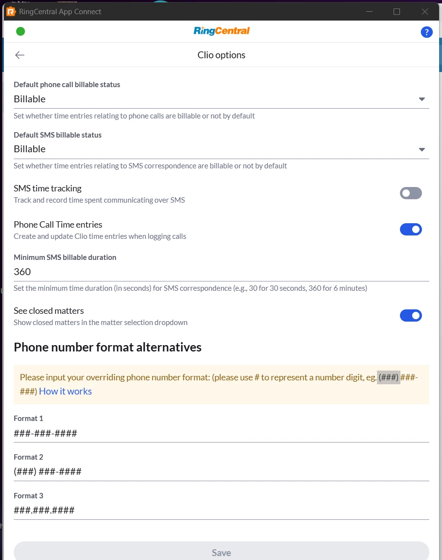

@KennedyDelaney They are found under Call Pop settings as shown in the screenshot below. We have updated the documentation to better direct people to this screen. Our apologies our docs were not up to date.
I am having the same problem with Clio contacts not being recognized; has any progress been made on this issue? My “Clio options” screen looks slightly different, using “#” instead of “*”:
  • April 20, 2026
@GRB_Oregon_Lawyer
Using # should work.
Quick questions. Did it work before and stop working? Or you have just begun to use the extension?
