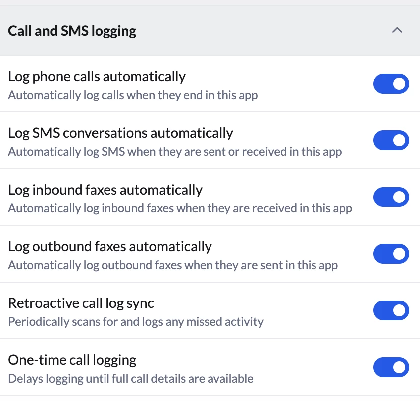

Here’s the logging settings I have enabled:

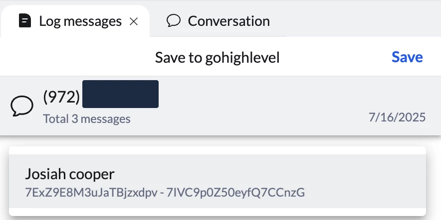

And here’s the contact showing that the link to GHL is there.
