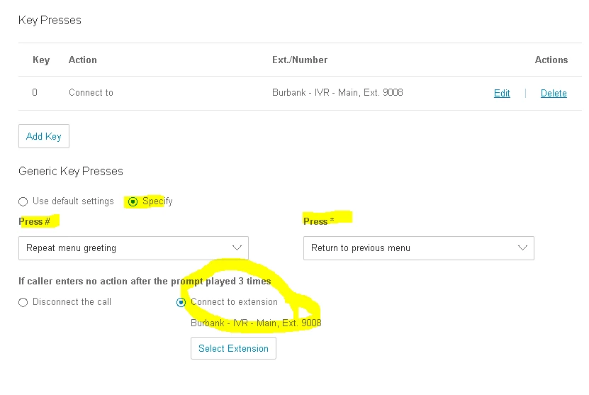

    Hi - for a structure like this to work, you have to think ‘backwards’ - what I mean by that is that you have to have all the message extensions created first (all the various endpoint exts) - then the mid-level IVR choices, and then the top level.
    On the mid-level you said that you couldn’t get past a point.  Look to the bottom of the Key Presses screen:
    Make sure that you give the caller a path to jump back/get out.
    Once you have all the extensions made, and the mid-level IVR, then it should flow something like this:

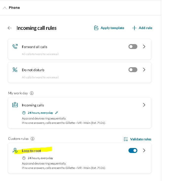

    Top  level - press 1 for city A - goes to the mid-level IVR - press 1 for specific location --> to then the extension of the message only.
    BUT! If you wanted more control over the final extension - make it a mobile user, and you can still make its incoming message about the address/directions - but then you can specifiy what to do afterwards:
    Hope this helps.  Let us know!
