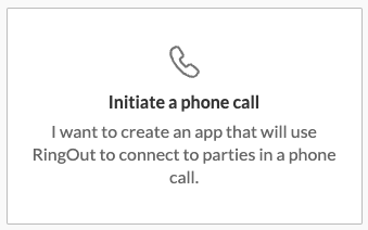

This article is provided to developers going through the getting started experience accessible from within the RingCentral Developer Console and needing help specifically with the "Initiate a phone call" code sample.
Initiate a Phone Call Screenshot
I am receiving an error when I run my code sample
The code sample provided for you is 100% complete and ready to go. You should not need to edit it in any way.

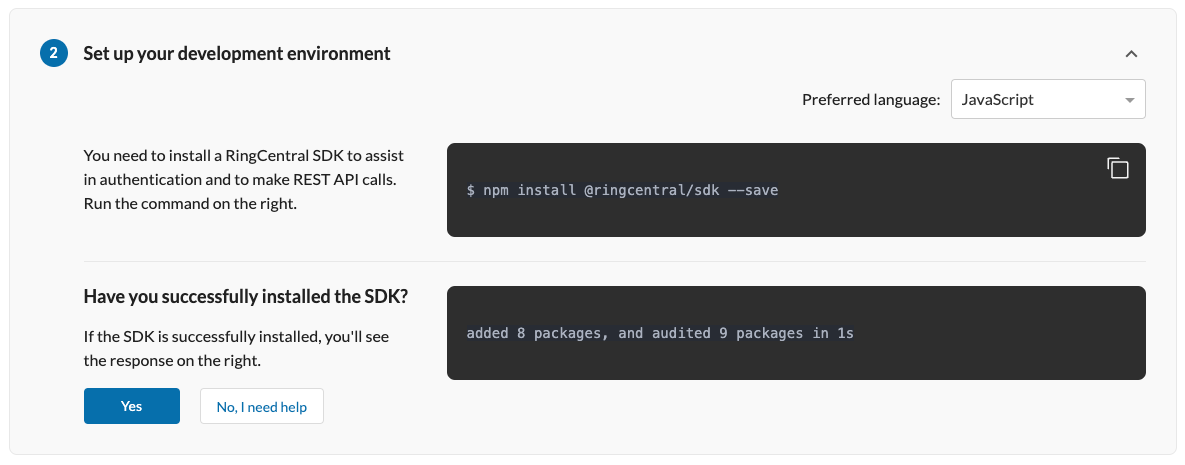

  • Make sure you installed the SDK.
  • If the error message relates to a missing library or a file that cannot be found, return to Step 2 on the Making a Simple API Call page and follow the instructions for your preferred programming language to properly install the RingCentral SDK.
SDK Installation Screenshot
