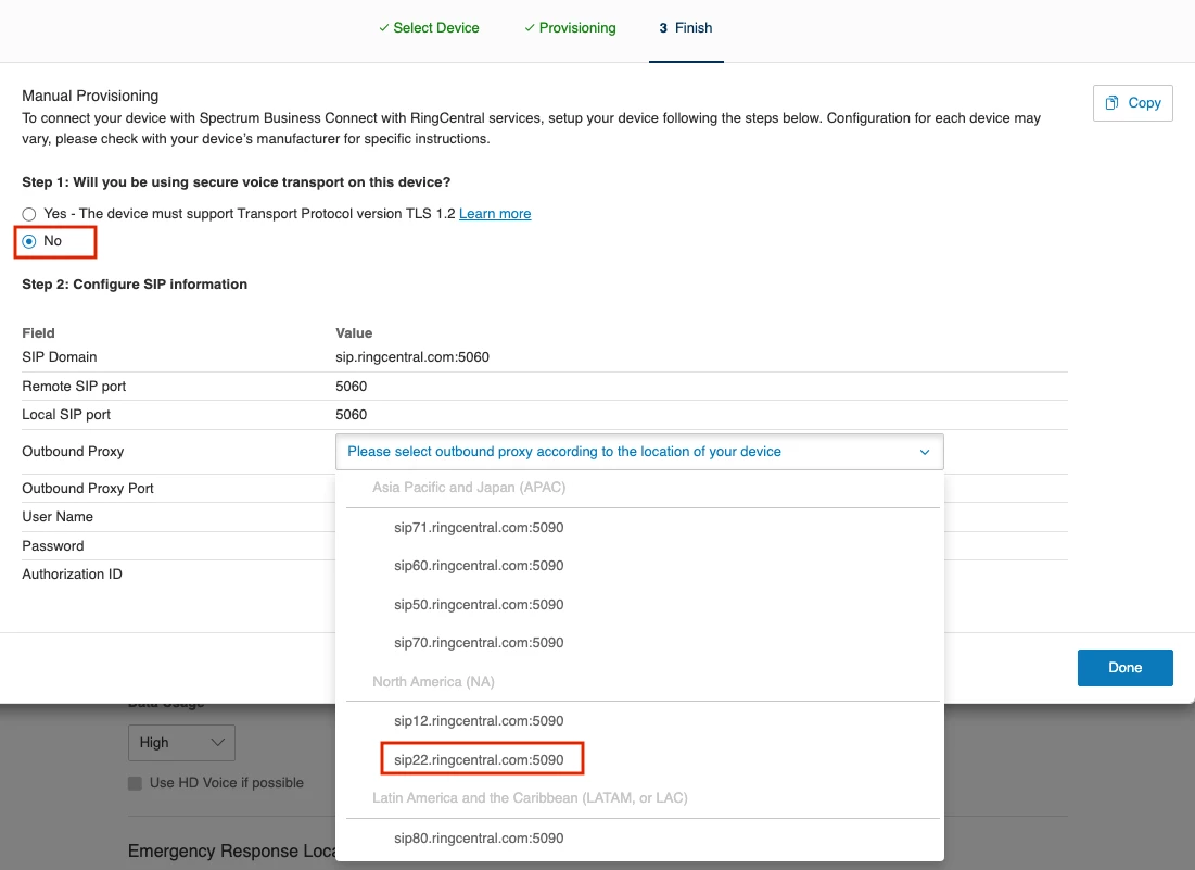

May 29, 2025 10:28 PM UTC
Brilliant.  All the points awarded!
Basically, all I did was to keep the Mitel using UDP, (default setting), and continued to use port 5090 and the only think I changed was to select the “No” option for TLS, and click the done button and voila! I can make calls!
Thanks so much,
