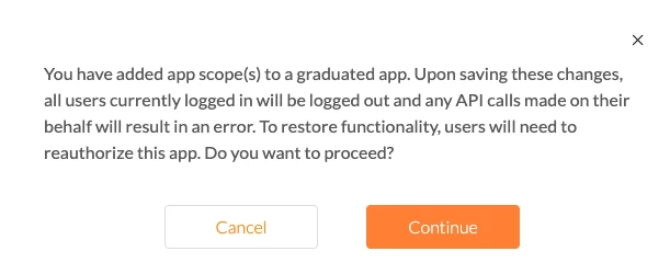

3. Scope addition / existing authorizations
When RingCentral enables VoipCalling on an existing Public application, what happens to existing OAuth grants and refresh tokens for that application?
Specifically:
  • Are existing users/tenants automatically unaffected?
  • Do they need to re-authorize because the application's scope set changed?
  • If re-authorization is required, does it affect all existing grants or only users who subsequently request the new VoipCalling scope?

3/ When submit the changes to the app settings, the system will prompt you to decide if currently authenticated users need to re-authenticate or not.
