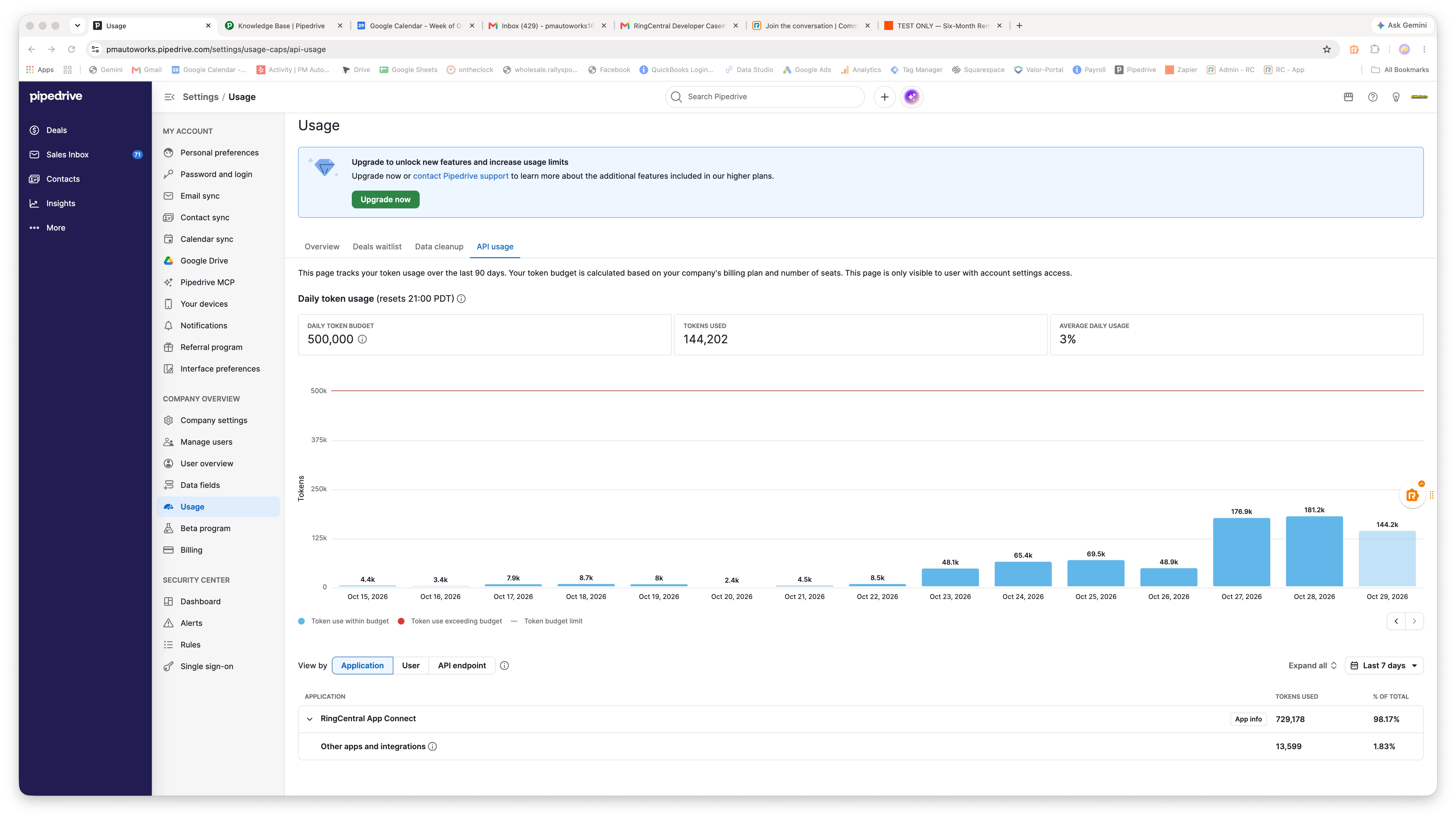

Here's what we're seeing:
  • Before October 23, our daily usage was generally between 2,400–8,700 tokens.
  • October 23: 48,100 tokens
  • October 24: 65,400 tokens
  • October 27: 176,900 tokens
  • October 28: 181,200 tokens
  • October 29: Already 144,202 tokens at the time of this post
According to Pipedrive's API Usage dashboard, RingCentral App Connect consumed 729,178 tokens over the last 7 days, accounting for 98.17% of our total API usage.
Our normal daily Pipedrive limit is 120,000 tokens. Pipedrive Support has temporarily increased this to 500,000 while the issue is investigated.

I've attached a screenshot of our Pipedrive API Usage dashboard showing the spike and application breakdown.

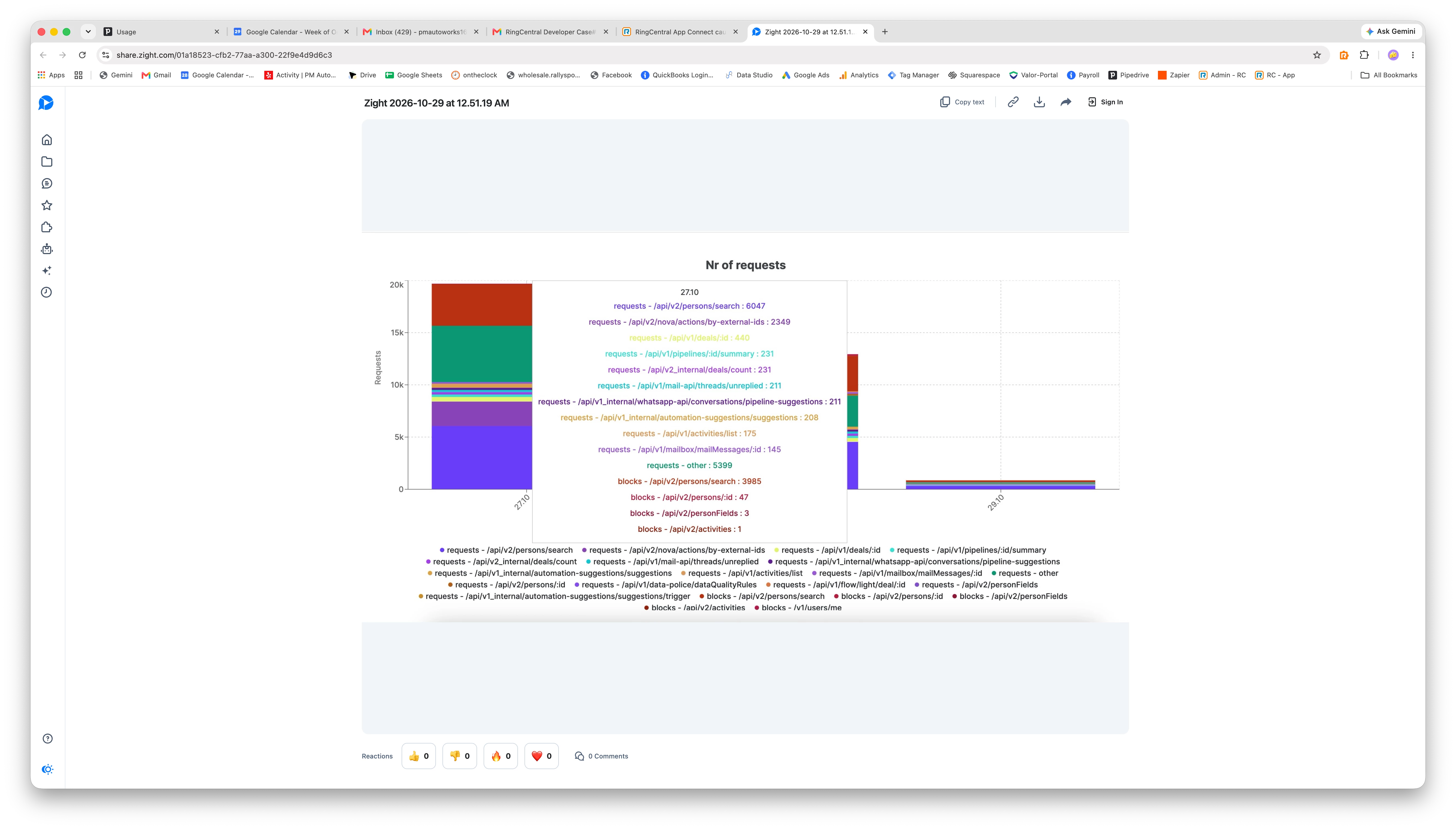

    • Approximately 250–500 contact searches per hour, continuously, including overnight
    • The app does not slow down after receiving HTTP 429 responses
    • Requests continue even after the daily API allowance is exhausted
    • Approximately 350 rejected requests per hour were observed between 20:00 and midnight UTC
    • An additional 45 POST /api/v2/activities requests failed with HTTP 400
