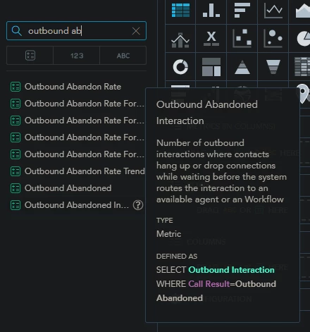

Mar 23, 2026 4:04 PM UTC
Yes, in Historical Analytics the name is a bit different. The Outbound Abandon Interaction is the metric that will give you this data point.

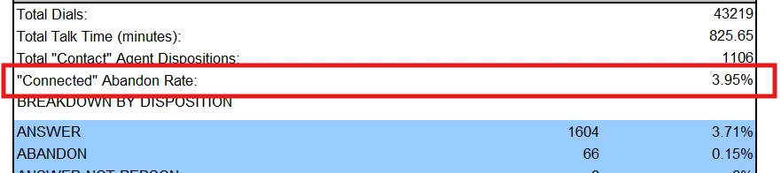

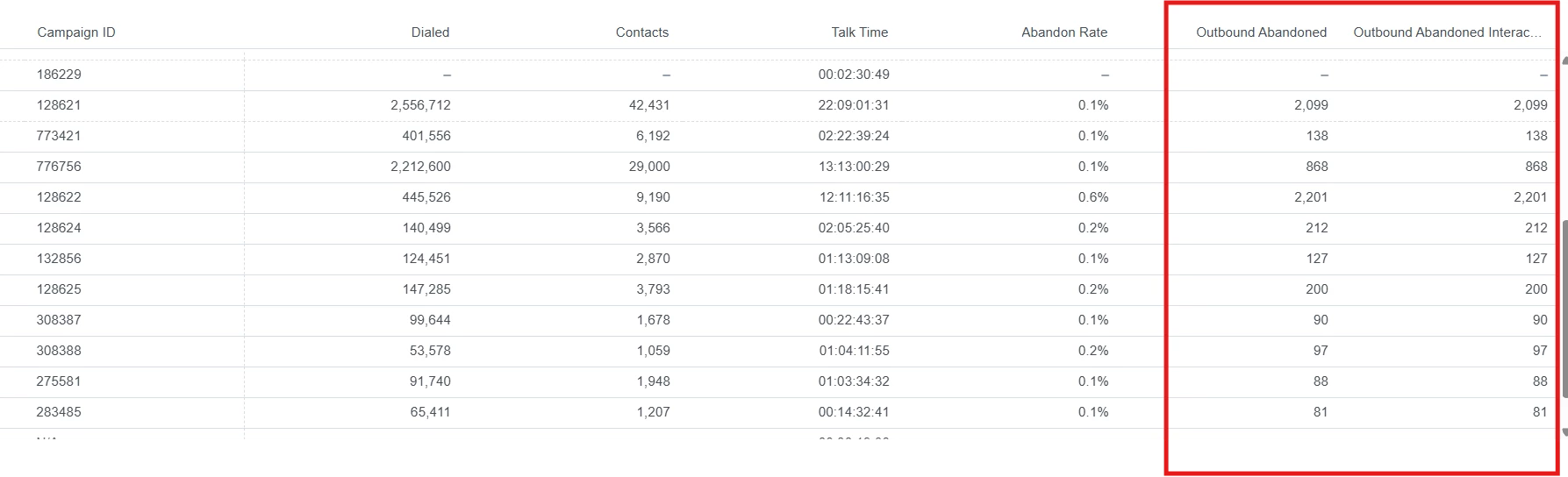

​@Austin Miranda  Hi! This shows the same number as Outbound Abandoned. We are looking for the % or # of calls that were answered by a live person and then were abandoned. Not the # of abandoned versus all dials.
I cloned the Outbound Overview and added your suggestion and these are the results.
Here’s an example from the “pre-built” reports.
